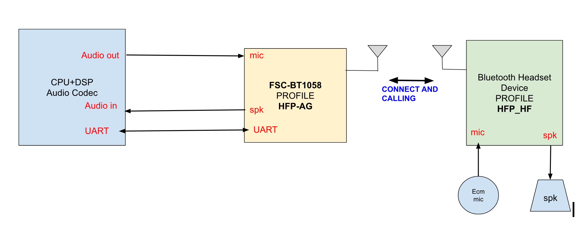

pongsatorn Thank you for your question regarding the FSC-BT1058 module's HFP-AG functionality.
We are pleased to confirm that the FSC-BT1058 module supports the HFP-AG profile for connecting and making calls via a Bluetooth headset (HFP-HF). You can achieve this using the following AT commands:

3. Establish A2DP/HFP audio
<< AT+AUDROUTE=1 //Establish A2dp audio
>> +AUDMODE=1
>> +A2DPSTAT=5 //Streaming
<< AT+AUDROUTE=2 //Establish HFP audio
>> +HFPAUDIO=1 //HFP audio established
>> +AUDMODE=2
>> +HFPSTAT=6
